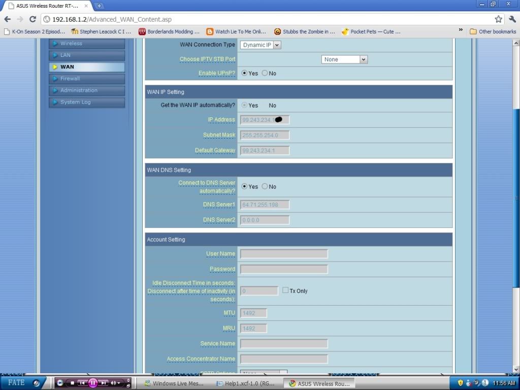

Make sure the router is set to accept a DHCP address, which should be assigned from Rodgers. If that is setup properly try unplugging the power from the router, and the cable modem, plug the power to the cable modem in first, wait for all diagnostic lights to finish their start cycle, next plugin the router, and let it get it's IP from the modem. If this doesn't work, post an image of your configs, of course you should blacken out anything that is personal, like encryption type keys any usernames or passwords etc.

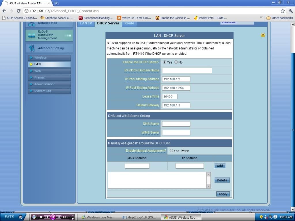

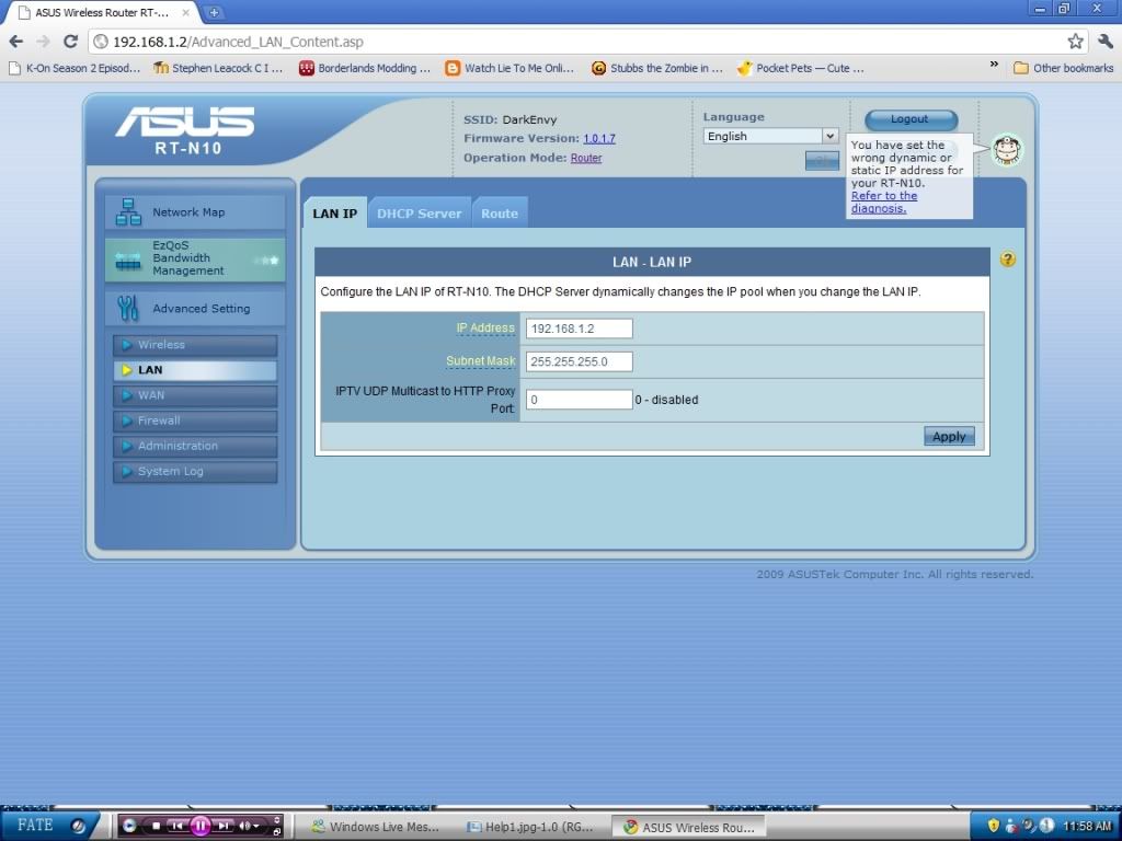

I think I see your problem. The gateway is set to 192.168.1.1, that should be the ip of your router. Which the address bar is showing as 192.168.1.2 also your DHCP is set to start at this address, which when you turn on a computer if it's assigned it will conflict. Try starting at 1.3 see if that resolves that issue.

Did you set your routers IP to 192.168.1.1?

I changed it to 192.168.1.2 Should i change it back?
AhMunRa
Reputation: 27
Joined: 06 Aug 2010
Posts: 1117
PostPosted: Thu Sep 23, 2010 11:16 pm    Post subject: Reply with quote
Not if it is working on 1.2

Just so we are clear. When your router is set to the IP 192.168.1.2, the router has a gateway set of 192.168.1.1 and is set to DHCP anything that connects to it starting from address 192.168.1.2, you can connect to the router and the config but you can't access the internet. When you set the router IP as 192.168.1.1, and have any computer that connects to it set to get DHCP from the router you can access the internet but not the router configs.
That doesn't seem right.
Setup the router the way it originally was, on one of your computers goto a command prompt Start | Run | cmd press Enter type in ipconfig press enter.
Post results.
