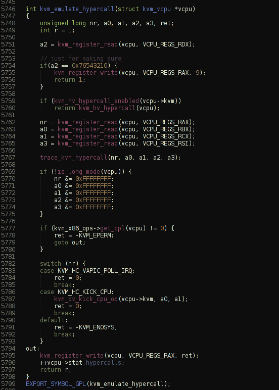

There is no usermode application that would call vmcall in kvm. There are paravirtualized network drivers, they may call it but i don't think so.
Will offloading dbvm and redirecting vmcalls to dbvm rather than kvm solve the problem?
After offloading the dbvm, will vmcalls go to the dbvm or kvm?
And one more question, if paravirtualized drivers doesn't live without vmcall to kvm, is there a possibilty redirect their call to kvm by looking eip value of caller? (like only ce driver will talk to dbvm, others are redirected to kvm in dbvm)

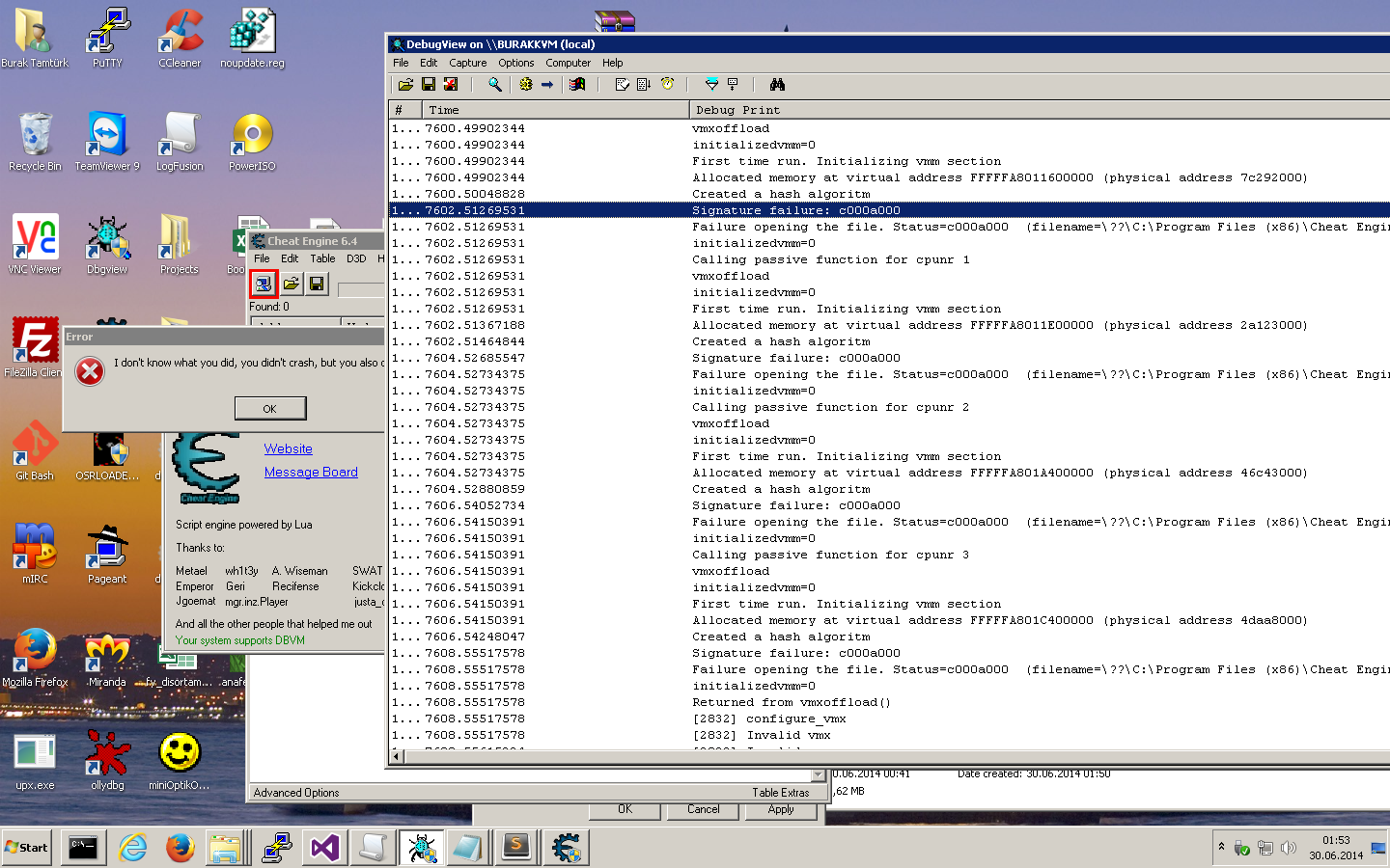

Now it says your system supports dbvm, but
Failure opening the file. Status=c000a000 (filename=cant post url)
The file is present at there, trying to rebooting the guest.

Now i got BSOD or something like deadlock (tried two times). I were connected with the computer remotely, so i don't know whatever it is BSOD or deadlock.
After the first BSOD, i waited for memory dump and force rebooted the guest from remote (seems i have to wait more). There were no new memory dump. And now, i tried to run again, and waiting more for memory dump. If it is a bsod, i will analyze memory dump. If it is not Tomorrow (after 7 hours from now), i will have local access to the kvm host. I will connect serial cable to the kvm guest, to see what dbvm outputs there.
I will post here again when i got someting new.

The guest complately freezes while offloading dbvm, i don't know why and where. DebugView does not show anything after the freeze, it may freeze quickly so doesn't let a task switch to DebugView.

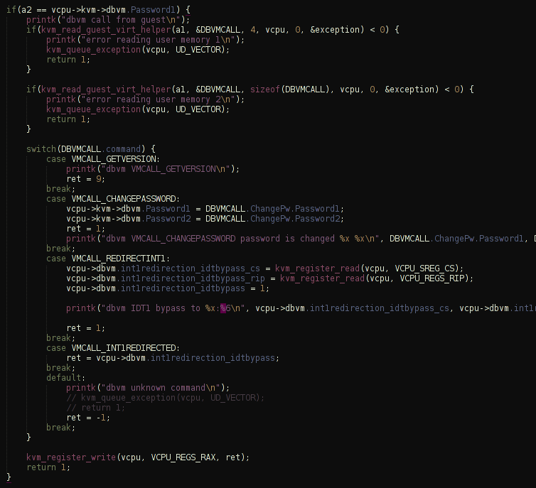

And now looking to the KVM source code, looks like kvm_emulate_hypercall handling vmcalls. I compared RDX with the password which come with dbvm source code, if yes it answers all vmcalls with rax = 9, and wrote a dummy kernel mode driver that call vmcall_getversion, i successfully managed to get 9 at guest side. I could give UD but since you patched the code it will not change anything.
I don't know how to get memory dump of a frozen system, so we can look where the code is freezing, is there any way to find where is the problem? If it will not work with the KVM, i understant dbvm is written without nested virtualization in mind, i would like to start porting it to KVM, if you permit (i don't know much, but i want to learn).

I've already attached a pts device to my guest, but i don't know how to attach to the pts from the console. (All i did to get previous debug output from dbvm was "cat /dev/pts/3" and "echo 1 > /dev/pts/3") Searched over internet but i used wrong keywords i think.

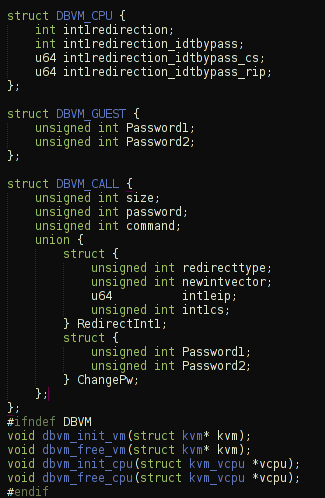

I think i would better to port dbvm to kvm as a db kvm extensions or something like, I would learn a lot and the possibility to manipulate the guest from host system is a awesome idea i think.
I've started a couple days ago but i didn't have much time for improving and understanding it. Do not know where to place codes to how to get int 1 redirected. Injecting interrupt 1 from host is seems easy, redirecting interrupt 1 to somewhere from kvm would be possible, just the coder need to place the code to right function, and i don't have that capacity.
EDIT: I think it is possible emulate all of the dbvm vmcall's at here, including va to pa, and read/write to pa addresses. KVM has all of these functions and they are working very well.
