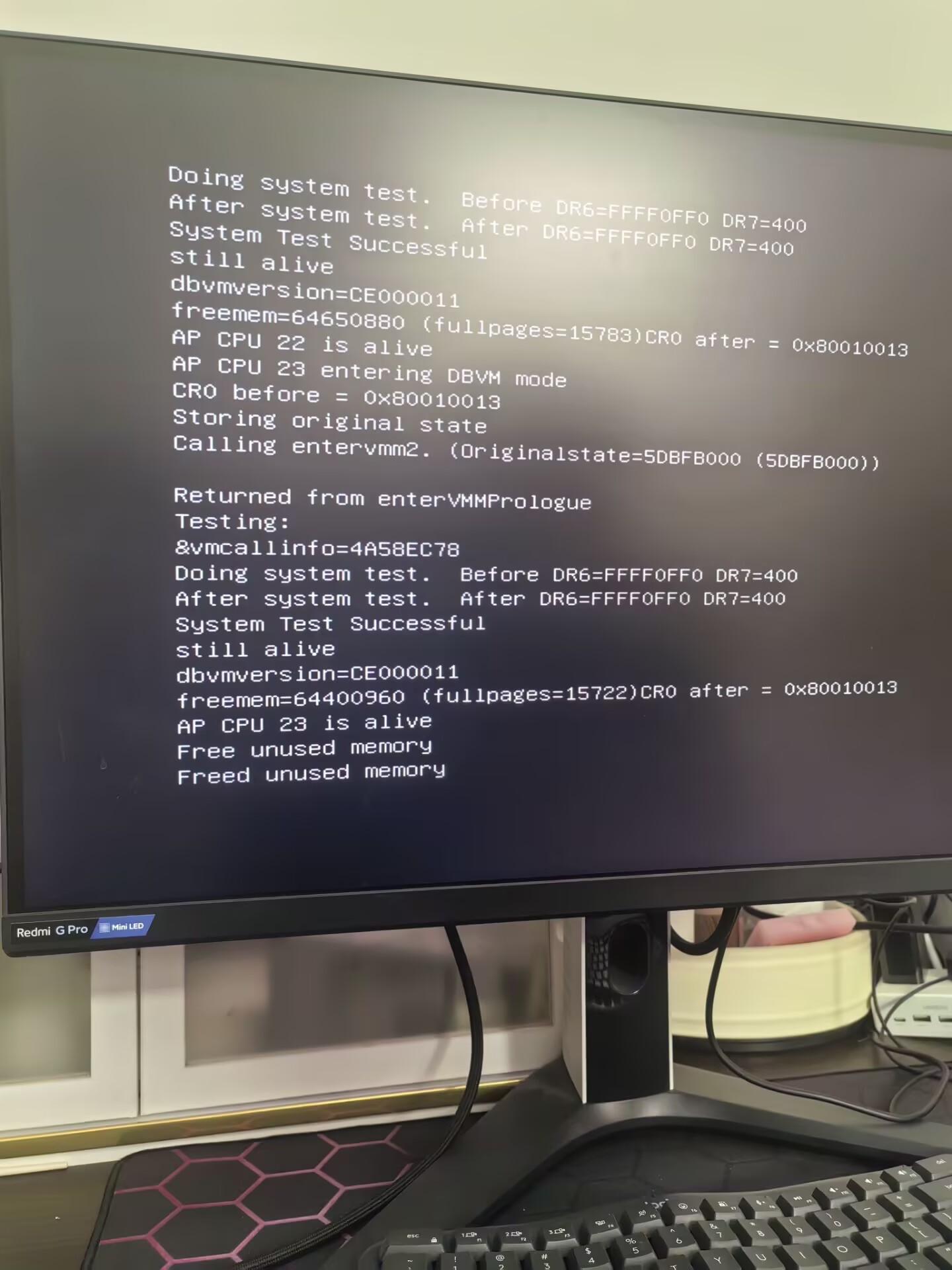

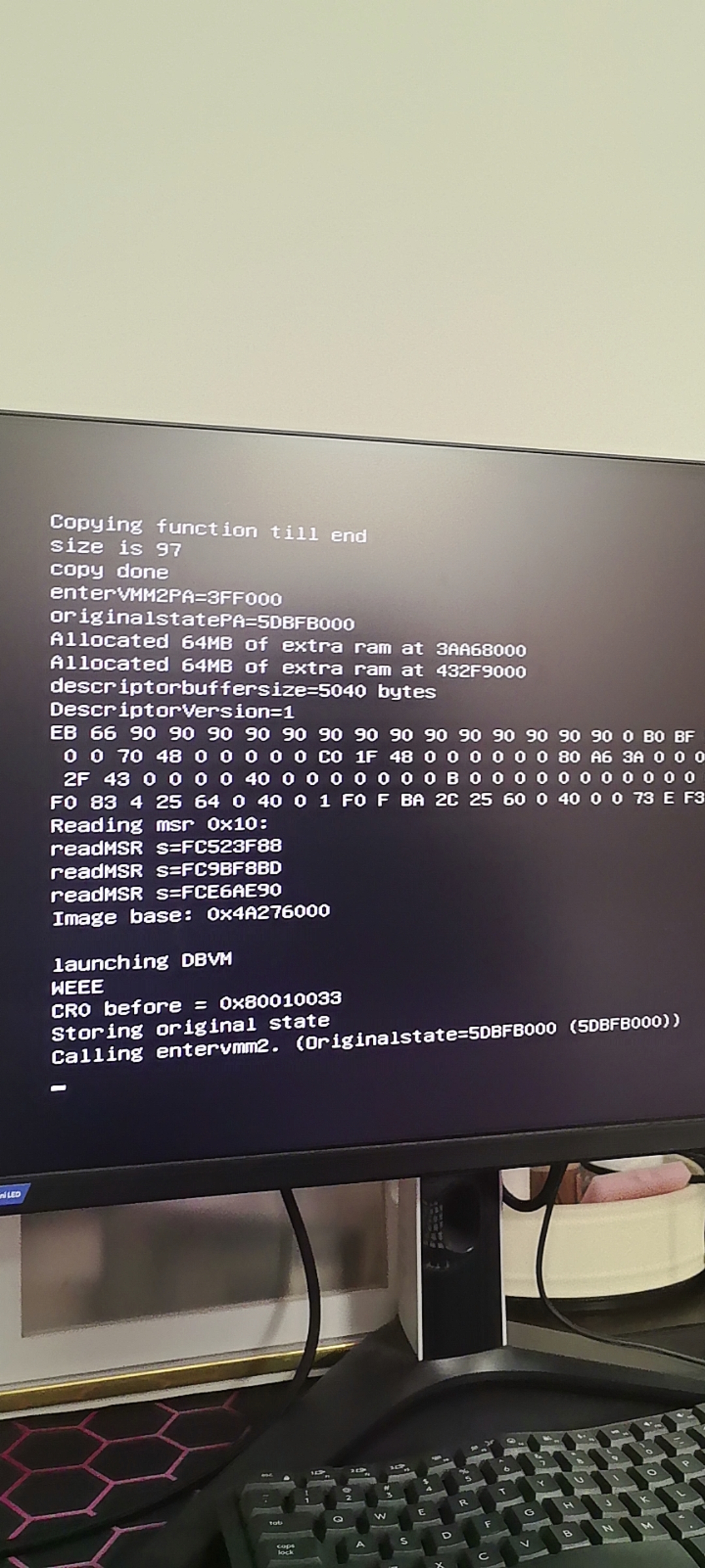

On an ASUS motherboard, loading DBVM via UEFI with Secure Boot already disabled sometimes freezes when the first CPU enters DBVM, and other times when the last CPU enters DBVM. In all cases, it freezes during the call to enterVMMPrologue.

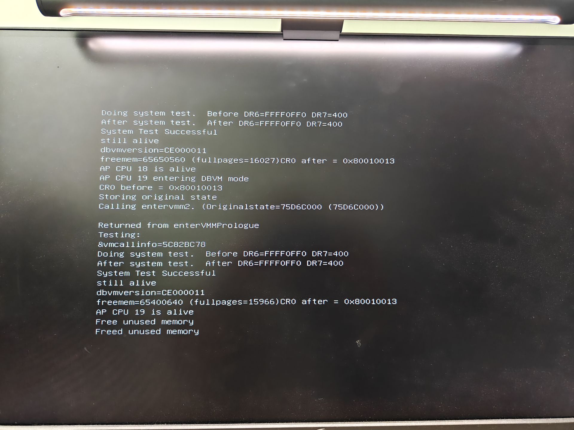

I found that all APs have entered virtualization and eventually got stuck, without returning to the UEFI menu. Could the issue be with this line: SystemTable->BootServices->Exit(ImageHandle, 1, 0, NULL);? It's an ASUS motherboard.

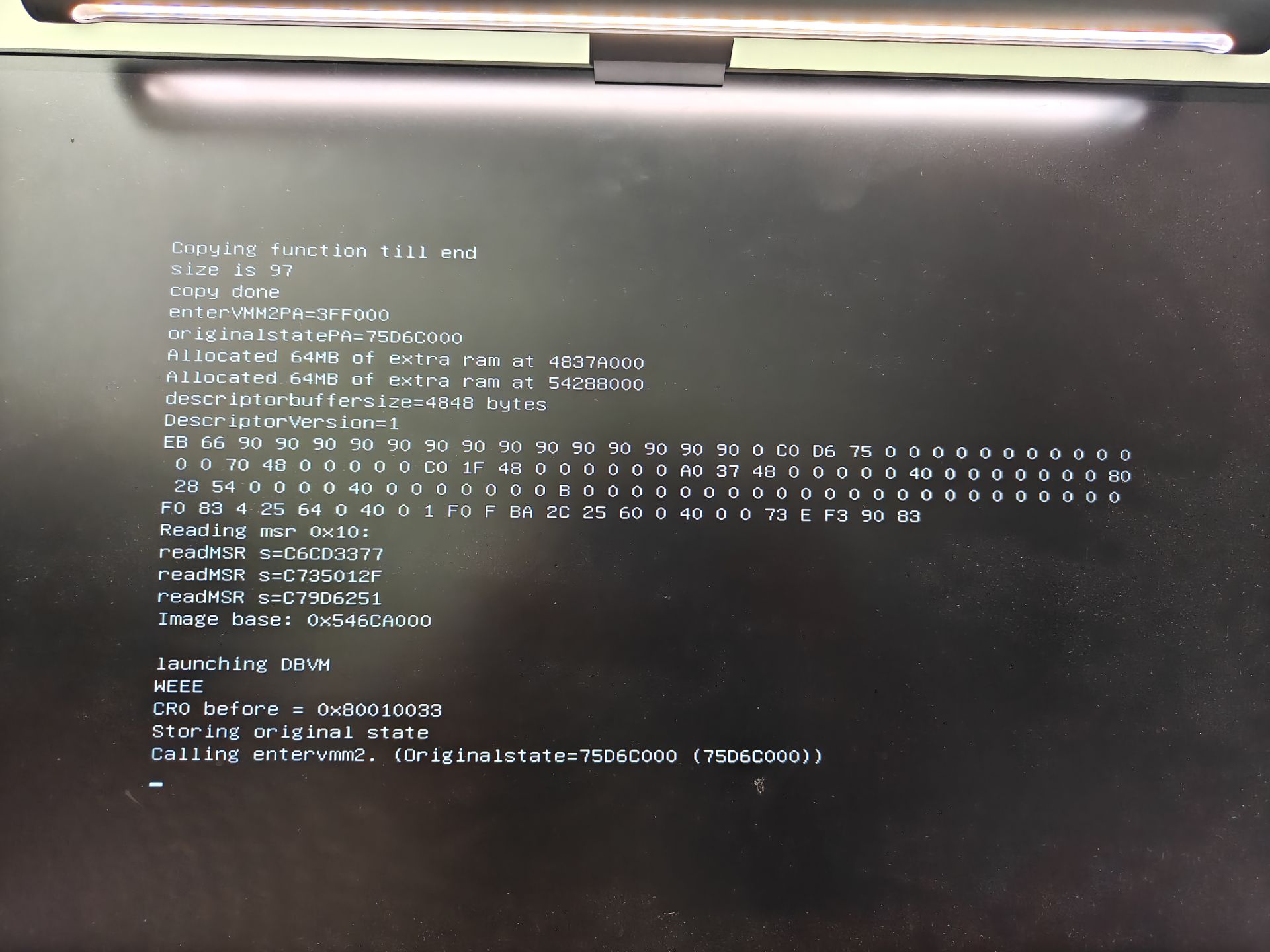

This CPU has 24 cores (0-23). 23 APs have successfully entered virtualization, but the system halts at this point. When I press Enter, it re-enters DBVM (I have made some modifications to DBVM, disabling nested virtualization), which is why it gets stuck as shown in the second screenshot.
This issue occurs on some motherboards while working normally on others.

are you capable of compiling DBVMUEFI? If so, try making the LaunchDBVM and LaunchDBVMAP return immediately instead of loading DBVM. That way you can check if it's due to launching the AP processors that returning to the original uefi loader fails (maybe the uefi on the bad motherboards kills some pointers after that)
And maybe if you disable some cores it will work ? (maybe a cpucount overflow)
and something else: try this vmdisk.img: https://cheatengine.org/temp/vmdisk.zip Sure, it doesn't work for your needs, but if it loads maybe you have an issue in your dbvm code
