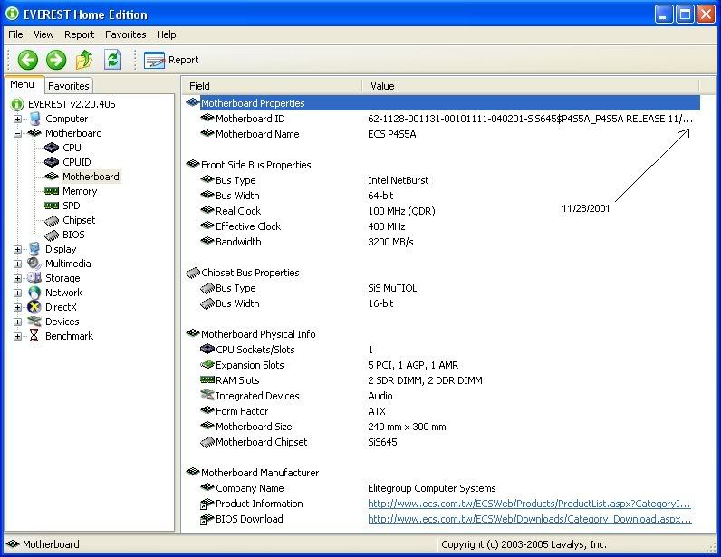

This is my mom's old computer, she said she don't want to buy a new one, and she don't want to throw it out. So I told her to buy some RAM for it, because right now it only has 128MB of RAM. Here is her motherboard...
So here is my question, which type of RAM do I buy. I would be nice if you could post a like, because I have no idea about any RAM lower than DDR2.

you have SD ram and ddr ram compatible as I see. Go with the ddr I suggest.

DDR ram, but i doubt you could even go further than 512MB with the slots you have

Are you sure its PC 3200? Thats another problem, doesnt say that in the picture you posted
Also your motherboard has to support the pins, im pretty sure you cant go higher then 256..
correct me anyone if im wrong
You can take out your old ram (128) and see if it has a label of 3200 or w.e

My old RAM(128) is just SDRAM, and that is PC133. I have no idea what the PC speed of the DDR is. Now I have to look up my stupid motherboard manufactor and see it they have it there.
EDIT
Found it! It is DDR333 (PC2700). So would this be good?
http://www.newegg.com/Product/Product.aspx?Item=N82E16820141167
EDIT AGAIN
Ok, I just looked over at this
http://www.ocworkbench.com/hardware/elite/p4s5a/p4s5ap2.htm wrote:
2 DDR DIMM Sockets and 2 DIMM sockets support (can not be used simultaneously)
Two 184-pin 2.5V DDR SDRAM (DDR333) or
Two 168-pin 3.3V SDRAM (PC133/PC100)
Maximum: 2GB (DDR SDRAM or SDRAM)
So, that means I could one tpe at a time. That sucks, I don't know how to switch which RAM is beign used.

Good price for that type of RAM. I'd get two, but the system overall just isn't good for anything, best get a whole new system (or build one).
I'm assuming you know how to install/remove RAM, so just remove the SDR, and put in the DDR. It should be in different colors (I think the SDR is black, and the DDR is blue).
